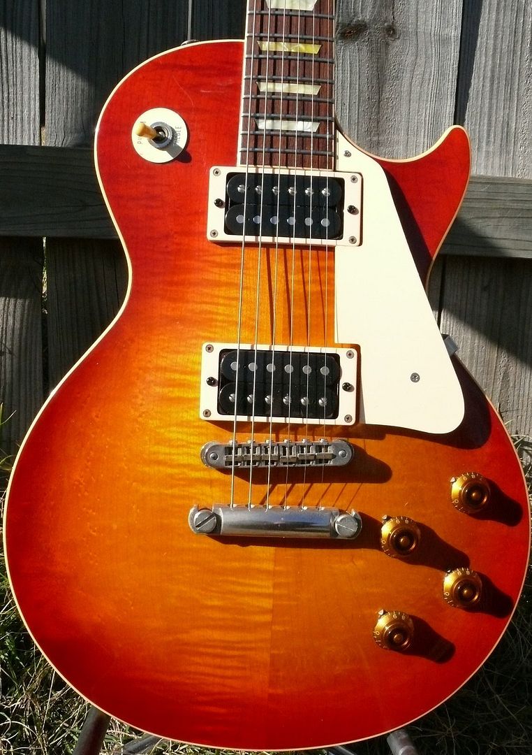

Hello everyone. As you know, I bought this gorgeous 89 OBG off of eBay. It has an amazing solid flame top instead of the more common veneer.
I bought this guitar because it was inexpensive so I could do with it whatever I want. Here is a pic after I unpacked it and unstrung it.

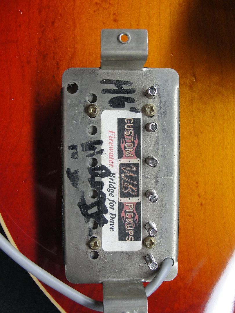

So I ordered an RS guitarworks kit, Gibson m69 pickup rings, Gibson back plates, Seymour Duncan custom shop pickups, and tone pros. Anyways, the wait on the Duncan's is 5-6 weeks and the tone pros aren't here yet either....so I bought 1 used pickup from a gentleman on this forum. It reads in the mid 14s and will be placed in a different guitar when the Duncans get here. The neck pickup is some Japanese dumpster and the bridge is a dubya bee FW. Soooo I started working on her yesterday. This thread is for those of you interested in following me in this little journey.
I placed her on my bench and went to work. The first picture is after I replaced the rings and installed the pickups ill be using for now.

You have a winner on your hands, congrats. If I remember from your earlier post, that is a G# Terada? If so, it is the best looking back from them I have seen. The top is beautiful- subtle flames.
How is the neck?
Yeah- you typically will always have to open up the pot shaft holes on MIJ's to change out to US. Just for future, it is better to manually bore them out with a round file, than to use a drill... even solid tops can chip.
My 2 cents on aesthestics... aged nickle covers, or double creams. And get rid of the goofy "Standard" TRC!
Your Gibson may become a backup to this one ;)

Yes it's a G coded Terada guitar. Thanks for the compliment. The top and back are awesome. The flames are subtle on my work bench but usually jump out a little more under most other lighting. The Birdseye in there looks great too.
The neck is actually quiet chunky which I like. It isn't quiet as big as a 50s reissue but also not nearly as thin as a 60s.
Thanks for the insight on the drilling. The neck tone did chip a tiny bit as I was drilling but it was very small and was covered up by the pointers.
I ordered the Duncan's in zebra so they will be exposed and already put a Jonesy aged truss rod cover on her.
Lastly, that will be ideal if I enjoy this one as much as my 97 R8 flame top. I also have the other 2012 figured and flamed R8 lemon top I just bought from an MLP member. She has big shoes to fill :)
Thanks for the input.
